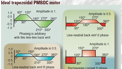

Ideal trapezoidal back-EMF motor
PMBDC motors were first described in the 1950s as three-phase, wye connected, trapezoidal back-emf motors with line-neutral back emf/torque functions. In this model, reference R phase remains at +0.5 for 120 electrical degrees until at 150° electrical. Then it decreases linearly to normalized value -0.5 at 210° electrical. Finally, the R phase remains at -0.5 for the next 120 electrical degrees until 330° electrical, when it rises linearly back to zero. In this way, it completes one electrical cycle over 360° electrical.
In the same interval, both S and T phases (see Fig. 1) undergo the same cycle, but shifted ±120 electrical degrees relative to the reference R phase. Hence, combining back emf/torque functions for a given phase pair using an arbitrary phase reference gives the line-line torque function in the upper left of Fig. 1. Notice that during one 360-electrical-degree cycle, line-line back emf for each phase pair is ±1.0 during two 60-electrical-degree intervals, with a total of six such intervals when all three-phase pairs are combined.
Ideal six-step drive
In combination with an ideal trapezoidal motor, Fig. 1 also shows what's called the “ideal” six-step drive. Below each line-neutral back emf/torque function is a switched dc current supplied to that particular phase — which spurs clockwise rotor rotation. Notice that for the R phase between 0° to 30°, 150° to 210°, and 330° to 0°, current is zero; at 30° to 150° and 210° to 330° its normalized current value is ±1.0.
During each ±1.0 R-phase current interval, either S or T is supplied with a ±1.0 current value so that during each 60-electrical-degree interval, two thirds of the winding is active: In other words, current is +1.0 in one phase, -1.0 in the second, and zero in the third. Combining all three phase pairs produces a six-step current switching sequence during each 360-electrical-degree cycle of T-S, R-S, R-T, S-T, S-R, T-R. In this way, the three phases work to produce constant, normalized 1.0 torque output (shown at the bottom of Fig. 1.) Counterclockwise rotation is made with the opposite current switching sequence: R-T, R-S, T-S, T-R, S-R, S-T.
