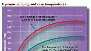

The four measured parameter values (and four-parameter thermal model) for one particular 60-mm-diameter servomotor are shown in Fig. 1. With 1x constant power dissipation, winding temperature begins rising immediately from 25°C ambient temperature. However, the case (and motor body) exhibits a temperature-rise time lag. As we'll explore shortly, this lag in central to the limitations of temperature sensors used for protection against overheating -- particularly if the sensor isn't attached directly to the winding.
For our 60-mm servomotor, winding temperature ultimately stabilizes at its rated 130°C maximum continuous value; case temperature stabilizes at 100°C when surrounded by 25°C ambient air temperature. However, this 30° gradient presents another problem: Where should temperature sensors be installed, and what type should be used? On-winding installation may seem best, but as we'll detail, this arrangement exposes the system to nuisance shutdowns.

In any case, consider Fig. 2: Our 60-mm servomotor with 1× continuous power dissipation shows that a winding temperature rise calculated by the four-parameter model does indeed rise faster than that from the two-parameter model. However, both curves converge at the rated 130°C maximum continuous winding temperature.
In fact, this is a feature consistent between the two models for 1× continuous power dissipation … which means that the simpler two-parameter thermal model provides reasonable accuracy in dynamic winding temperature estimation so long as power dissipation inside the motor doesn't exceed its 1× maximum continuous value.
