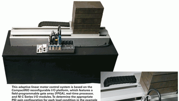

Case in point: Linear motor adaptive PID control system
This approach was recently demonstrated on a linear motor control system using a reconfigurable I/O platform. Engineers at National Instruments set up an adaptive PID control system to automatically detect and retune itself for payloads from no weight to 120 lb. The engineers regularly added 20-lb weights to the linear motor carriage while it was in motion, requiring that the PID values be retuned.
In the system, a high-speed digital input module reads the linear encoder signals, which are converted to position and velocity feedback in the FPGA. Forward and reverse limit switches on the linear motor connect to a digital input module to provide a reference for the home position and to enable the enforcement of interlocks — which disables the drive if the linear motor travels outside the valid range of motion.
A 24-V digital output module sends drive control signals for enabling, disabling, and stopping motion. To increase performance, the PID control algorithm is executed in the FPGA at high speeds; the FPGA-based PID controller output is a torque command, which is transmitted to the servo drive using an analog output module.
Because the PID control algorithm comes from the FPGA and identification functions from the real-time processor, setup is simplified. After successful system identification and calculating new PID gains for the application, the real-time processor application sends the updated PID gains to the FPGA. This provides a clean architecture in which the FPGA is responsible for time-sensitive control tasks, while the processor executes the system identification functions at slower loop rates, sending updated PID gains only when valid identification results are available. More specifically, in the prototype by NI engineers, the system identification loop executes at a 5 Hz loop rate while the motion PID control loop in the FPGA executes at loop rates up to and beyond 20 kHz.
A recursive ARX model estimator function from the LabVIEW System Identification Toolkit estimates inertia. The torque command sent to the drive serves as the stimulus signal; velocity measured by the encoder is the response signal. With this, the ARX model estimator detects load changes. Because PID torque output is the stimulus signal, the model estimation is not affected by changing PID gains. In addition, using the recursive least squares (RLS) method allows the model to be updated dynamically while the system is running.
