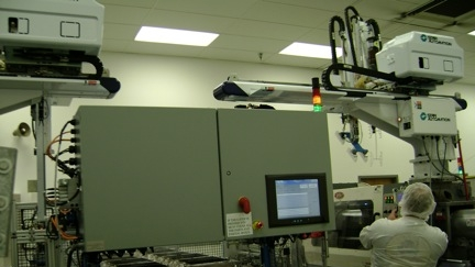

Physically, the packaging system is split into mirror sides consisting of an Accumulator and Conveyor that service one Star Robot drop-off. The Accumulator stations collect parts until two rows of sixteen parts are in place. It then pushes these parts into the Pick and Place staging area. The packaging system is shown in Figure 2.
Figure 2 – The main packaging machine communicates with and receives parts from two asynchronously running Star Automation robots which remove parts from the injection molding machines.
The Pick and Place robot receives pick requests via a named queue from either Accumulator station. Once it receives the pick request it moves over to the pick area and clamps the parts and places them into a box that the Conveyor system has moved into place. After the Pick and Place robot has puts the parts into the box, it retrieves a piece of foam sheet from the foam magazine and places it over the packaged layer. These steps are repeated seven times until there are 224 parts in the box.
When the Conveyor state machine detects the current package is full, it sets a functional global to let the Pick and Place know to not service any more pick requests. The full box is then ejected and an empty box is brought into place below the Pick and Place robot. When the new box is correctly positioned, the functional global flag set earlier is reset to reenable pick and place operations.
