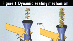

Cam model: Following the cam paradigm, the programming task might be approached by predefining the x and y motions of the mechanism via cam tables — as shown in Fig. 2. Here, the motions are defined according to our knowledge or assumptions of the process requirements. For example, we could predefine a sealing time of 150 msec and define cam profiles based on the current machine speed accordingly.
This method might be acceptable in situations where the sealing process is fairly consistent. In the case of format or process changes (such as longer bag length or increased sealing time), cam tables could be recalculated to accommodate the new requirements, although these changes could not be realized during the current machine cycle. At best, the new motions would be loaded into a memory buffer and would be available for activation only in later machine cycles. Even so, abrupt changes in film-feed speed could result in over-sealing or under-sealing.
Event-driven model: Suppose instead that the machine could monitor the sealing process — using a thermocouple mounted to the sealing surface or an external timer — and send an alert when the process is complete. The machine would then immediately open its sealing jaws and return to the start position in preparation for the next cycle. Doing so minimizes total travel, resulting in lower average velocities over the machine cycle at a given machine cycle rate. The general idea is illustrated in Fig. 3.
This type of setup requires the motion to be defined with a certain amount of flexibility built in. First, the motion profile must be able to respond to the external event itself.
Additionally, it must be able to compensate in-process to the variability implicit in any event-driven scenario. In other words, the motion plan must be able to adjust automatically regardless of when the trigger event occurs. Note that the cam approach described previously cannot realize this optimization because changes to the cam motions will only take effect in later machine cycles.

Returning to the VFFS example, Fig. 6 illustrates the sealing mechanism's horizontal motion as a function of film position. Because the jaws must only come into contact with the film once the speeds of the mechanism (in the vertical direction) and the film match, the first segment is defined as a synchronous segment.
The next segment is defined as a time-based step whose length is given as the maximum possible seal time. In the example case here, an external timer or some other process monitor triggers the end of the sealing process: The maximum seal time is used to define the default behavior of the Flex Profile. The sealing bars then open, again according to a time-based master — in other words, at a defined rate of speed. The duration of the final step, in which the sealing bars are fully open, is calculated internally by the system. This is the so-called flex step, during which there is a transition from a time-based step back to being fully synchronized with the real or virtual master.
Fig. 7 illustrates the vertical motion of the sealing mechanism, again as a function of the film position. Here, all profile segments are synchronous with the master.
Step one defines the vertical travel of the mechanism as it tracks the film; this is the step in which sealing occurs. When the external event signals the end of the sealing process, step one is aborted and there is an immediate transition to step two, during which the mechanism travels with the film for a short distance to allow the jaws to open.
In step three, the jaws return upward to their starting position. As in the previous case, the final step is a flex step, meaning that the system automatically calculates a trajectory such that the machine returns to the defined start position at a fixed master position.
