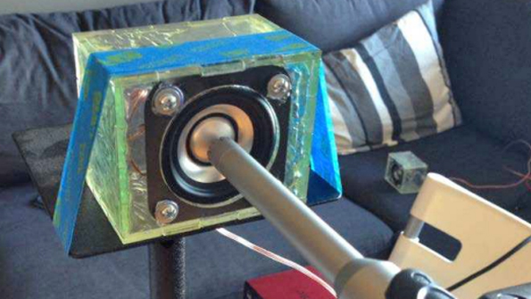

It’s relatively easy to measure the electrical parameters, but the other parameters must be calculated based on a series of acoustic tests that measure the speaker output over its full range.
The tests require specialized software and a highly linear reference microphone. To compensate for room acoustics, the results combine the low-frequency response of a near-field measurement with the high-frequency response of a far-field measurement (Fig. 6). Go here to see a detailed description of the audio characterization process.
6. This near-field speaker testing setup requires specialized software and a highly linear reference microphone. (source: TI)
Smart amplifier manufacturers offer hardware and software tools to automate this process. Together they help the designer gather detailed measurements of the target speaker excursion, output level (SPL), and temperature to fully understand the speaker's capabilities. The result is a configuration file that the production microcontroller downloads into the smart amplifier DSP on boot up.
