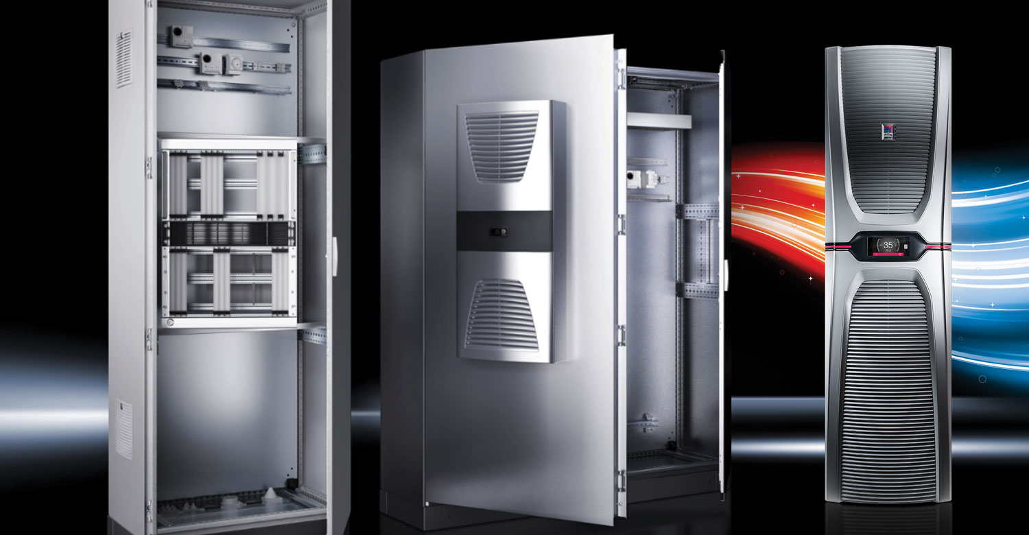

Climate control. Efficiently managing heating and cooling loads within the enclosure lets factory owners protect the controls and electronics inside while meeting the demand for reduced energy consumption. Climate control options for enclosures include:
Ÿ Air cooling (fans and heat exchangers)
Ÿ Cooling units (thermoelectric coolers)
Ÿ Liquid cooling (chillers)
Ÿ Enclosure heaters
To improve thermal management in enclosures, add accessories such as thermostats, hygrostats, filters, water distribution, and air routing.
Efficiently managing heating and cooling loads protects controls and electronics while increasing efficiency. Rittal’s Blue e+ cooling units use an innovative hybrid process for active heating and cooling.
