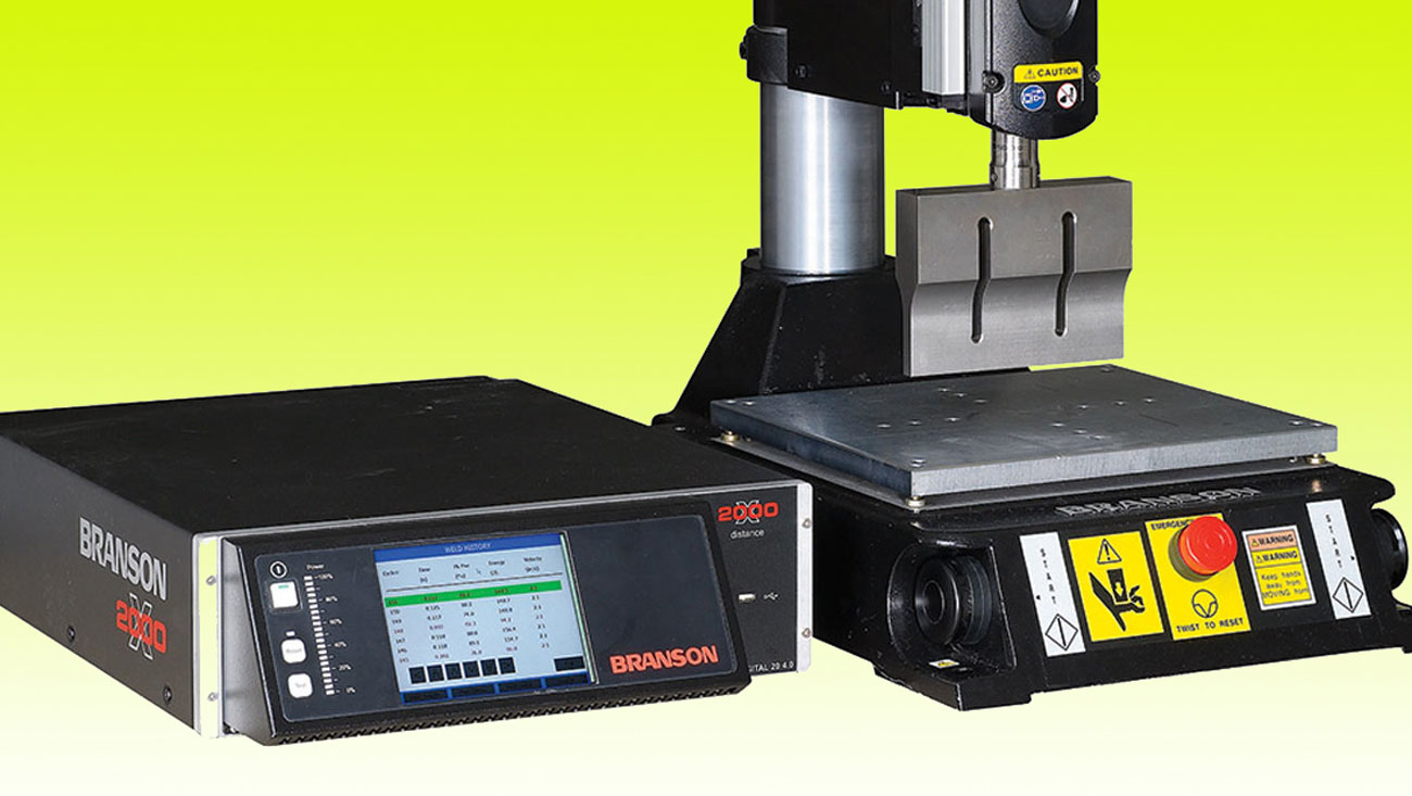

Ultrasonic welders, such as this Branson 2000 XC, consists of a power supply (left), a stack assembly that includes the converter, amplifier, and horn (top right and front), a pneumatic actuator (rear at right), and a base equipped with a metal fixture or anvil.
