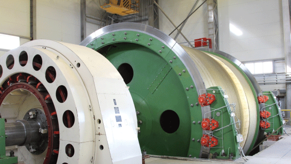

INCO Engineering has seen this value firsthand by offering Transdatic, an advanced, remote-monitoring system, for its mining hoists. The system continuously monitors conditions of selected equipment, and data is securely transferred to INCO’s central service center. If an issue occurs, INCO staff can notify customers immediately—reducing the customers maintenance costs. Staff can also analyze the most frequent faults, helping customers make equipment and process adjustments to prevent further occurrences.

INCO’s central service center is provided with continuous data and operational status for its mining hoists. This is one way that smart machines are leveraged in an advanced network to provide capabilities like predictive maintenance.
