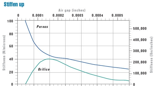

The stiffness factor
Once a bearing is stable, stiffness is usually the most important performance characteristic. It is the ratio of the change in air film thickness in response to a change in load. The thicker the air gap, the more compressible it will be. Therefore, to optimize stiffness, air gaps must be small. Porous bearings have the advantage here because they can fly at small air gaps without collapsing.
Collapse occurs when the gap becomes so restrictive it starves regions for flow and pressure. You can see this condition in reverse during initial lift off. Consider an orifice bearing grounded by a load. Slowly increase air pressure from zero. Notice that it will take almost the full operating pressure to make the bearing pop up and establish flow across the face because only the area of the orifice and any distribution grooves are available to establish this initial lift.
Porous bearings achieve initial lift with a lower percentage of the operating pressure because air bleeds from the entire face. Film thickness gradually increases with pressure. Thus, lift is not as dependent on flow across the face.
Therefore, these bearings offer higher stiffness because they can fly on thinner air films. Thin air films also exhibit a "squeeze-film" damping effect that makes control of precision systems easier. Note that in this case, it is possible to increase stiffness and damping simultaneously.
Additionally, because porous bearings do not collapse they do not crash like orifice bearings. The porous surface creates a lifting force even with no lift, mitigating damage from contact.
