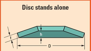

Single disc. Even a single disc can be used as a spring. The load-deflection curve for one disc is curved and regressive. Its degree of curvature depends on the ratio of the disc free height (h) to the material thickness (t). At small values of h/t (up to about 0.4), the line is almost straight, but curvature increases as the ratio increases. Also, a thin disc gives more curvature than a thick one.
Discs with an h/t ratio exceeding 1.3 tend to deflect through the flat condition, which may cause permanent set and reduced fatigue life. In such cases, it's generally best to limit the deflection to 75 or 80% of the total available. This can be achieved by using discs with more capacity than necessary or adding a stop to limit deflection.
