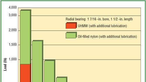

Sometimes it’s easy to tell when polymer bearings will not work, but there may be borderline situations where both metallic and non-metallic varieties have favorable points. A simple PV formula can tell whether a polymer bearing is up to the speed and load requirement. P is the pressure (psi), and V is surface velocity (ft/min). A P vs. V graph is nonlinear. Each material has a maximum pressure and surface velocity, but a plain bearing cannot be exposed to both maximums concurrently; the bearing is rated according to the PV product.
Load is pressure over area; for journal bearings the pressure area is the diameter of the cylinder times its length. The surface velocity is 0.262 x diameter x rpm.
The maximum PV rating for dry (no additional lubrication) UHMW-PE is 2,300 psi-ft/min. With supplemental lubrication it can be increased to 4,000 psift/ min. The generally accepted maximum for oil-filled nylon is 16,000 psi-ft/min.
