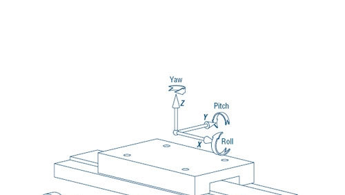

Just when you thought you had the “linear motion” concept nailed down – hit the required points on the straightaway and you’re home – along comes the remaining five degrees of freedom to crash the party. From a coarse perspective, it’s true, a linear carriage translates mainly along one axis (call it the X axis), but all engineered parts have imperfections, and with our ever-increasing need for accuracy and precision, our attention to detail must also progress accordingly.
To thoroughly describe system accuracy, then, we must account for all six degrees of freedom, these being translation in the X, Y, and Z axes, and rotation about the same.

Linear motion devices consist of two essential components, a linear guide and a device to produce thrust. The guide is responsible for restricting motion in 5 of the 6 degrees of freedom available in three-dimensional space. The ideal guide allows no translation in the Y and Z axes and no rotation about any of the axes whatsoever. The thrust device (commonly a lead or ball screw) is, of course, expected to produce motion only in the unrestrained axis. It is convenient to evaluate the accuracy of these two components separately and then combine the results to determine the overall accuracy.
Let’s look to the guide first. A linear guide may suffer from several sources of error: curvature up and down or side to side – in other words deviations in flatness and straightness; vertical runout; and discontinuities between guide and follower.
Flatness and straightness are the most common concerns, as they are generally greatest in magnitude. A perfectly made guide travels along a plane parallel to the X-Y plane and, furthermore, along a line parallel to the X axis. Flatness error is essentially deviation from the X-Y plane. It may encompass simple curvature in one or two directions. Flatness error always creates translation in the Z (vertical) axis. Depending on the orientation of the curvature, it may cause pitch rotation about the Y axis, roll about the X axis (the case with two-dimensional warp), or both. Warp may also generate slight translation in the Y axis, perpendicular to the desired motion.
Straightness error results in the carriage’s line of travel leaving the parallel with the X axis, curving into the ±Y direction. Besides displacement in the Y axis, it will induce a yaw rotation about the Z axis.
(To clarify the terminology it might help to look at the three rotations from a pilot’s perspective. Pull back or push forward on the stick to pitch the plane up or down, move the stick to the side to roll the plane, and depress the rudder pedals to induce yaw rotation for a “flat” turn.)
Vertical runout is a systematic change in the height of the linear guide as it translates. This may be due to inaccuracies in the manufacturing of the bearing surfaces, creating translation in the Z axis. Most guide manufacturers list flatness or vertical runout, along with straightness. It is possible for a linear guide to induce instantaneous Y or Z translation without rotation, but the magnitude of these is usually small. The linear guide follower tends to distribute the imperfections along its length, suppressing sudden shifts transverse to the desired motion.
The effect of rotation on accuracy depends on where the point of interest is relative to the position-referencing device, which is perhaps the lead screw itself or a linear scale used for feedback. In either case, the location of the device forms the line of measurement, parallel to the desired move direction. The point of interest, however, which is the target point of the linear motion system, may be offset from the line of measurement. Any rotation, therefore, will cause different arc lengths at each. And, the actual move distance will vary from the distance registered on the scale according to the amount of rotation and the offset. The larger the offset, the greater the translation errors due to rotations – known as Abbé error. With the lead screw itself used as the referencing device, the line of measurement is on-center. But linear encoders are typically used, and are mounted to the side. This could worsen or improve the conditions for Abbé error, depending on the location of the point of interest (it isn’t always aligned with the carriage and lead screw).
In contrast, pure translation errors in the Y and Z axes due to discontinuities and vertical runout remain constant regardless of the point of interest. Errors from rotations can be far more deceiving. It is generally easier and more cost effective to minimize offset than to build a positioning system with more precise guides.

To determine overall accuracy along one axis of travel, guide and thrust device errors must be combined. Rotational errors are converted to translational at the point of interest. This error may then be combined with other translational errors in the same direction.
Abbé error is calculated by multiplying the tangent of the total angle change about the axis of rotation by the offset distance. For each rotation, the offset should be taken in the plane perpendicular to the axis of rotation. The only way to virtually eliminate Abbé error is to position the feedback device at the point of interest.
Once the guide’s translational errors are calculated in each direction, they can be combined with the error from the thrust device, which contributes to error along the X axis only, and the total system error is quantified.
If you are analyzing a single-axis linear motion device, you can simply compare translational errors for each direction with your positioning requirements. If any axis has unacceptable error, you can address that axis’ error components one at a time.
If the system is multi-axis, with several linear motion assemblies, you still have only one point of interest; it’s the same for each axis. The furthest axis from the point of interest will have the highest potential for Abbé error. Translation errors from each stage can be summed at the point of interest to determine total system error. However, orthogonality between the axes must also be considered now. This produces a pure translation. In the case of an X-Y stage, for instance, a skew of the Y axis with respect to the X will produce an additional X translation as the Y axis traverses. This can be determined with trigonometry or by directly measuring the offset. Remember, unlike rotations, translations are independent of the offset, the distance to the point of interest. You can add the orthogonality offset directly to your overall error budget.
