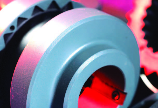

Couplings are probably the most compliant and predictable component in a motion system. Turn up the speed, however, and it's a different story. Learn how to address this engineering issue.
Couplings are probably the most compliant and predictable component in a motion system. Turn up the speed, however, and it's a different story. Resonance, misalignment, and lubrication become major issues. And lifetime can be anyone's guess.

Galen/Rockwell-Dodge: Arguably, the most important coupling feature at high speed is balance. Small mass variations about the axis of rotation can be devastating at higher speeds. Material types are also very important. Centrifugal forces developed at high speeds generate a lot of dynamic radial stresses. Stronger parts with higher tensile strengths and increased ductility are more reliable here because they can tolerate the increased stress levels. Lighter materials are helpful as well because they're less affected by centrifugal forces.

Sarah/Ringfeder: For high-speed applications, completely metallic couplings are the standard because metals are stronger than elastomers in tension induced by centrifugal forces. Here, alloy steels are preferred over mild steel or cast iron because alloys have greater tensile strength.
Stiffness is another important factor. Speed causes deflection or motion in many couplings. These variations in the distribution of mass often create imbalances that cause vibratory pulses that can damage equipment or the coupling itself. At high speeds, a standard gear coupling can actually begin to orbit within its sleeve. Similarly, in metal disc couplings, bolts may shift inside the holes of the disc and hub, creating an imbalance.
