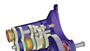

New developments in computer-based modeling of geared systems are now allowing the design of gear microgeometry for durability and NVH — for realistic in-service duty cycles in a virtual environment. However, ideal designs can rarely be manufactured, as mass production always exhibits geometric variability. Here we review an automated approach to optimize microgeometry, and how Monte Carlo simulation methods can be used to investigate microgeometry designs. (Here, Monte Carlo method refers to a class of algorithms that model systems with repeated random sampling.) We'll then analyze the example automotive gearbox pictured above — not only for nominal NVH and durability performance, but also for immunity to manufacturing variability.

Transmission model
Consider our model in Fig. 1 at this article's opening, a five-speed manual transaxle gearbox. The analysis that follows is solely of third-gear-pair microgeometry design, a detail of which is shown in Fig. 2. A duty cycle histogram for 3rd gear has been calculated from road load data and is shown in Fig. 3; the nominal torque capacity for this transmission is 170 Nm. The duty cycle includes both drive and coast conditions and a number of shock loads which exceed the nominal capacity for short periods of time. A condensed design load duty cycle which comprises a single load case (at the maximum nominal load) is derived to represent the equivalent damage of the full duty cycle — 170 Nm for 17 hours.

Model with housing cutaway
Our example five-speed front-wheel-drive manual transaxle gearbox above is modeled in RomaxDesigner software; the detailed static and dynamic model includes shafts, bearings, gears, synchronizers, differential, and housing. • Simple shafts are modeled as one-dimensional Timoshenko beams. • Complex shafts are modeled as three-dimensional FE components. • Rolling-element bearings are modeled as six-degree-of-freedom nonlinear components. • Gears are modeled with several macro and microgeometry parameters. • Radial and axial clearances are modeled using non-linear contact elements, and the housing is modeled as a three-dimensional FE component.
