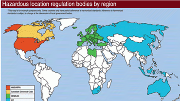

To ensure the safety of systems operating in hazardous locations, governments worldwide have established regulatory bodies that have developed testing and certification standards and product marking requirements. Some countries have coordinated the certifying process, creating reciprocity agreements with the different agencies, and allowing certifying bodies of one country to test and certify to standards of another country.
Even so, with various classifications of hazardous locations, different nations have developed standards for equipment installed in these environments — and a patchwork of requirements has evolved.

In fact, the United States (ANSI/NFPA), Canada (CEC), Europe (CENELEC), and much of the rest of the world (IEC) use this approach to area classification.
Once engineers have answered the above questions, they can determine both the hazardous area rating needed and the certifying body that must approve the equipment or installation.
Two main classification systems exist: The Class, Division, and Group system is used to classify hazardous locations in the U.S., Europe, and other parts of the world use the Class and Zone system, also called the CENELEC system. Let's explore both of these classification systems in more detail.

Many countries around the world operate under different hazardous location standards and classification guidelines. Certain regions in the world have coordinated, or harmonized, their standards, but there is no single worldwide hazardous location standard. In Europe, CENELEC is the body that coordinates the standards of member nations, and ATEX is the directive from CENELEC that governs hazardous locations. In the U.S., the National Fire Protection Agency (NFPA) and ANSI produces the National Electric Code (NEC) that codifies hazardous location installations. Other countries are members of the International Electrotechnical Commission (IEC), which also sets hazardous location standards. CENELEC/ATEX and IEC standards are largely the same, although products must be certified and registered for each if they are expected to operate within both jurisdictions.
Determining a design's final installation location may seem like a simple step. However, many end users will need an encoder installed to suit their local hazardous area: If a builder is an OEM that ships machinery worldwide, it can be difficult to pinpoint the equipment's final destination. Often, this means the engineer will need multiple agency ratings on the encoder being installed. By having multiple ratings on one product, this allows much greater flexibility as to where the product can be used.
