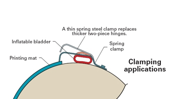

Bladders also offer significant savings in installed cost and part count. For example, in high-speed web printing presses, small inflatable bladder actuators operate clamps that hold flexible mats in place on the transfer roll, which spins at a few hundred rpm. The bladders themselves weigh two thirds less than traditional electric or magnetic clamp operators, and exert uniform opening force over the entire clamp length. The newer bladder design also cuts assembly cost to one third, and part count to one sixth.

Bladders can also fit in tight spaces — as in our press-clamp application, for example. Inflatable actuators are often retrofitted or integrated into existing design spaces that would never accommodate a cylinder or stepping motor.

There are exceptions: One is the straight actuator used in press clamp openers. Here, the actuator fits into an existing space, held in place by the wedging action between two members. Retention is usually achieved by installing the actuators into some rigid channel. Adhesives may be adequate for less demanding applications. For the footed types, standard mating channels or metal clamps are available.
