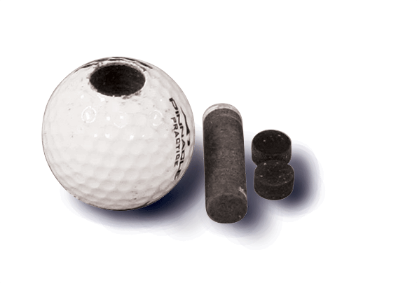

Engineers at Veryst dissected a host of golf balls to determine the composition of an average ball’s core and many layers.

At Veryst, engineers were preparing to simulate that impact. The first step was to get an accurate and representative model of a golf ball—data the USGA did not have. So the team took core samples of several golf balls, dissected them, and then carried out a detailed engineering post-mortem. All of the balls were constructed similarly: a polymer core surrounded by several thin layers of plastic and other materials. They also shared a dimple pattern on the hard, white outer covering.

The team took thin, penny-sized samples of each material and put them through a few material tests. In one, samples were compressed relatively slowly compared to the speed at which the materials would get compressed in an actual impact. The samples were compressed until they reached a specified amount of deformation, with the test instrumentation recording the force involved.
