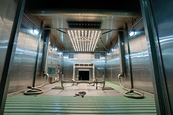

Specially outfitted wind tunnels, such as this one at TCC/I, can replicate weather from practically any country on the globe, including high and low temperatures, extreme winds, and wet, humid conditions.

Climatic wind tunnels have a variety of testing capabilities. For example, some, like T/CCI’s tunnel, provide stratified airflow. That means airflow is fully uniform from its originating point at the nozzle to the vehicle’s A-pillar around its windshield. This lets technicians accurately simulate the frontal airflow on a vehicle and its effects on the performance of various components as the truck is going down the road.
Climactic wind tunnels let technicians test alternative components and designs under the exact same conditions, including nasty weather while staying inside and comfortable in the tunnel’s control room.
Some climatic wind tunnels let technicians determine the pressure setting at the front of the vehicle at ground level. They can also simulate heated roadways and generate valuable data for trucks and construction vehicles that spend their days working on hot asphalt. After all, asphalt can be 160° to 170° on hot summer days in many parts of the country. When a machine pulls onto a road that hot, it can cause problems that would put it out of commission.
