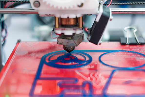

Pictured is belt cover printing on a Lulzbot TAZ 6 with a MOARstruder print head (GNU FDL).
However, even the desktop 3D printers are growing up. For example, the latest Lulzbot TAZ ($2,500 for 11 in. × 11 in. × 9.8 in.) recently came out with a new extruder called the “MOARstruder,” which sharply diverges from the longstanding trend in desktop 3D printing. In order to obtain high details and small features, 3D printer nozzle size has been dropping to complement a typical RepRap's 100 micron positional accuracy and z-step height minimum for reliable printing of many thermopolymers. The MOARstruder has a 1.2 mm diameter (as compared to a typical 0.3 mm diameter) along with an extra-long heater block and dual print cooling fans. This allows much higher output and thus much faster printing speeds. It enables the 3D printer to dump up to 100 grams (0.22 lbs) per hour, which can help machine designers with both faster rapid prototyping as well as full production of some products. For example, see the figure at left of a belt cover component printing from a MOARstruder for a shredding machine.
