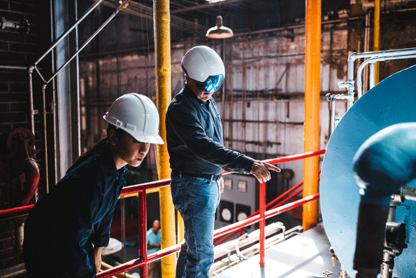

Once the information is sent to a device, the worker needs to be notified about the communication and be able to view it. While a headset would offer constant communication, headsets aren’t certified for eye and head protection (Z87.1 and Z89.1, respectively). DAQRI, an AR development company, focused on safety and a worker's capability when it launched its developer edition of a smart helmet. This will help engineers communicate on new levels with technicians in the field. The developer edition helmet is out right now and the company is undergoing the ANSI certification process.

For example, AR technology could highlight hidden bolts or parts. Experienced engineers could use it to learn a new job or machine. In addition, “Visualizing data offers contextual awareness to make faster decisions,” notes Kammerait. “These faster decisions can improve safety. Data, such as how hot an object is or overhead loads, can keep workers out of the line of danger.”
