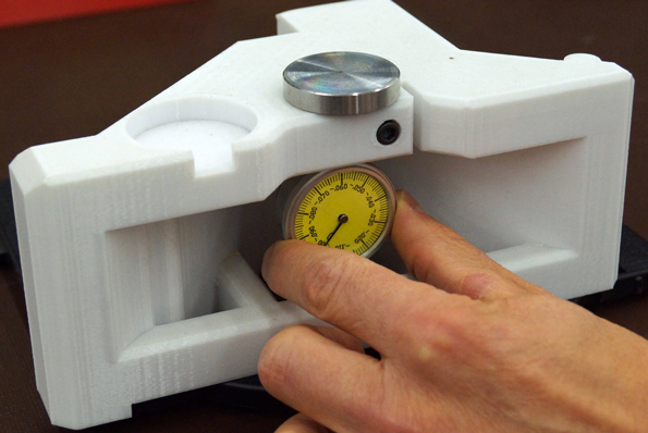

1. This calibration fixture was created for use with one of their 3D printers during production.
1. Calibration fixtures, which regulate the position and depth of a feature (Fig. 1).
2. Shim fixtures, which align part components for even assemblies (Fig. 2).
2. This shim fixture was created for use with one the Dimension One 3D printer during production assembly fit checks.

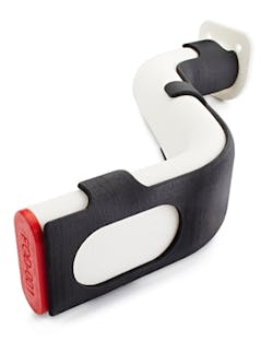

For example, Rutland Plastics appreciates PolyJet multi-material printing for use as a holding fixture (Fig. 6).
6. Rutland Plastics uses PolyJet as a low-impact manufacturing aid because it prints in flexible, soft-touch materials that are ideal for delicate, glossy surfaces.
Rutland Plastics uses PolyJet to print in rigid white material with flexible black over-molded surfaces and inner features. The flexible black material showcases built-in work instructions. The rigid material aids in durability while the flexible material provides a soft touch surface for Rutland’s products that have glossy, cosmetic surfaces.
Rutland estimates that PolyJet aids have saved them roughly $600 when compared to a CNC machined holding fixture. While PolyJet is not a durable option for long-term manufacturing aids, it can be an ideal solution for short-use fixtures because it can print a new part within hours and provides elastomeric options.
