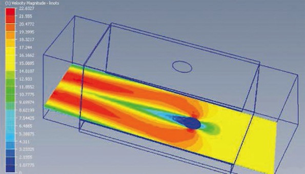

During a recent squall, a new 40 footer had her rolled-up double headstays oscillating violently back and forth perpendicular to the wind direction, and the stays were shaking hard. This action was disconcerting to the boat’s owners, to say the least, so we decided to try to pinpoint the cause.
The wind was blowing 15 to 16 knots with gusts to 26 knots. The frequency of oscillation of each headstay was about 1.6 to 1.8 cycles/sec. The rolled sail formed a 6 to 7-in.-diameter cylinder. A pure guess of the amplitude of vibration put it at 10 to 12 in., side to side, for a total movement of about 20 to 24 in. This large amplitude or “rig pumping” was surprising because the wind was not that strong.
The challenge was to model fluid flows in computational fluid dynamics (CFD) software to pinpoint the problem with the particular roller-furling configuration.

At first it seemed the Karman pattern rolled off the first headsail and hit the second rolled sail in its wake.

For a 55-ft length of rolled jib in 70°F air, the drag force is 26 lbf in 16 knots and 64 lbf in 25 knots of wind. This is a large force for so little wind.
So what do these results mean for the average cruising sailor? When a rolled jib is about 6 to 7 in. in diameter, the flow velocity maximizes periodically 18 to 28 in. behind the jib. This happens to be the separation distance of some of the double headstay designs. Based on the one analysis, this appears to be a bad place to locate the second furler.
