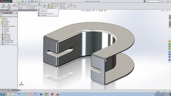

The Sheet Metal program has a new Corner Relief tool that lets one feature have multiple corner styles. Lofted Blends let designers pick transitions on the fly. If they’re modeling a transition between a round stack and rectangular duct, they can either pick a smoothly formed or faceted-bent transition. The flat patterns update depending on what’s specified.
