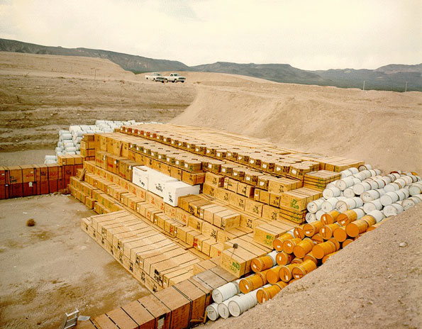

This is a permanent burial site for low-level radioactive waste (LLRW). Such facilities house waste encased in concrete.
