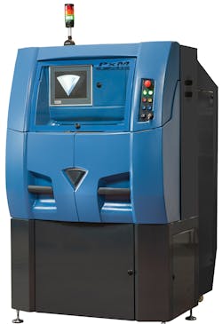

3D Systems’ Phenix PXM 3D printer uses direct-metal laser sintering to make parts out of various metal powders. It can also use ceramic powders to make ceramics parts.
Office compatibility, together with MJP’s capabilities, make it well suited for direct investment-casting applications in jewelry, dentistry, medical, and aerospace applications where digital workflows provide significant time, labor, quality, and cost advantages. MJP wax printers also offer a digital drop-in alternative to traditional lost-wax casting processes, eliminating time and expense while still using traditional casting methods and materials.
