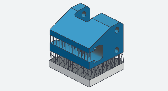

1. Holes and Channels: Making Nothing with Something
First-time users of 3D printing can get carried away with thoughts of creating amazing Swiss cheese-like structures. But each additive technology has its own limitations on the widest channel that can be built without needing support structures.
When designing large holes and channels, the key is to find ways to use the power of gravity to defy gravity. For example, arches work because the stones above the ground (especially that magical keystone in the middle) press against each other laterally to maintain their vertical structure. It’s the same with printed parts. To avoid sagging in channels and holes, consider using alternative shapes like diamonds or circular holes with a vertical rib.

3. Angles can be Functional and Cosmetic
Most technologies need at least a 45-deg. angle from the build plate to avoid support structures. This is important when optimizing designs for additive manufacturing. In most cases, supports are removed manually, which limits the accuracy of supported surfaces. Also, a myriad of supports will increase the build and finishing time, and therefore the cost of the part.
On the flip side, up-facing angled surfaces will have some degree of stair stepping. Shallow angles will have the most noticeable stair stepping. In addition to communicating functional needs, it’s also useful to communicate cosmetic needs for parts. The more cosmetically pleasing they are off the printer, the less cosmetic work must happen afterward.
