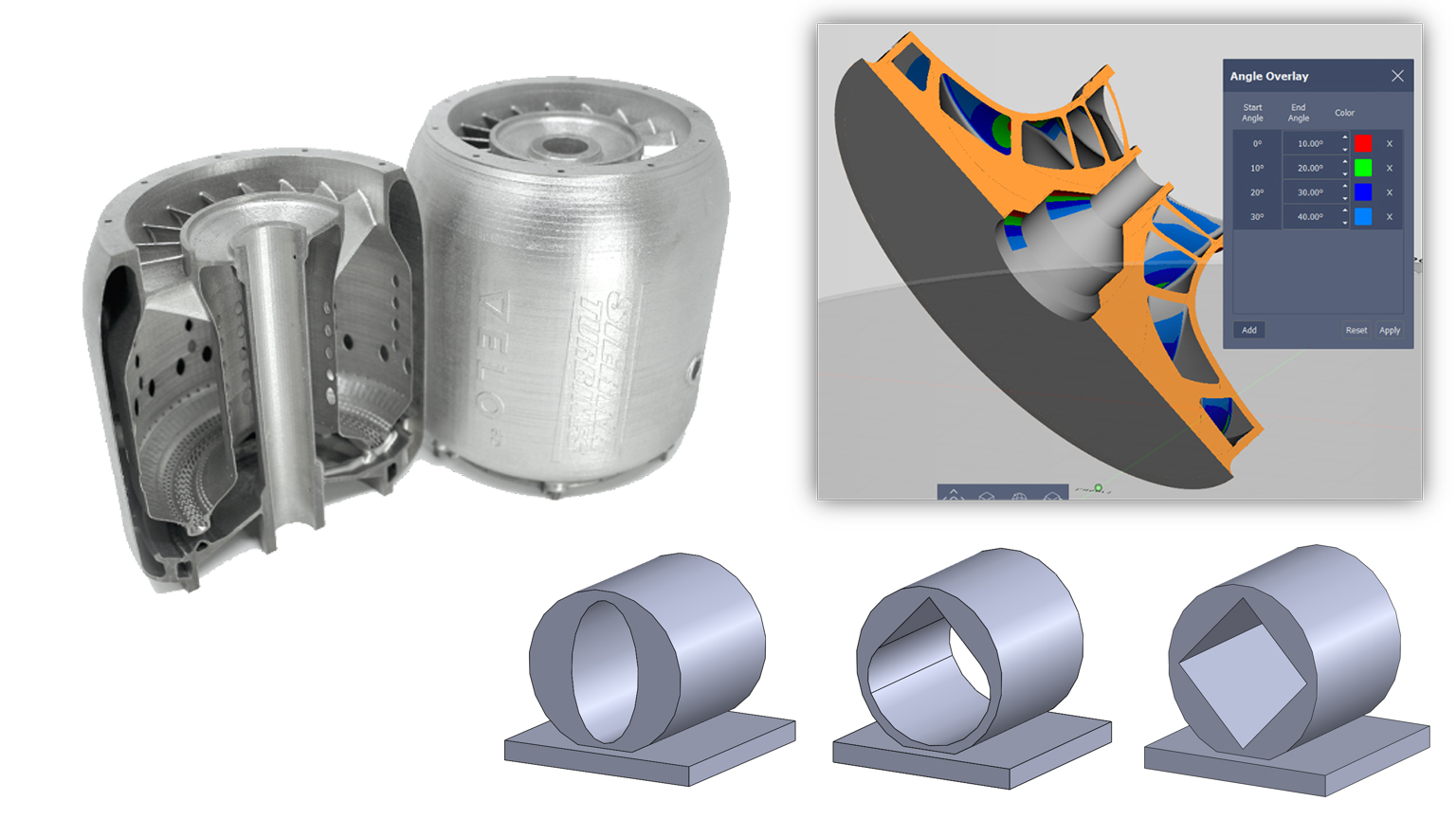

Photo collage

There are three solutions to this problem: reorient the part in the build chamber, redesign the part or add extensive supports. Many resort to reorienting the part in the build chamber, but this comes with its own problems. Take a circular part, such as the impeller shown in the image below.
Many people approach shrouded impellers like this by tipping them up at a 45-deg. angle. The problem with printing at an angle is that breaking the axisymmetry of the part leads to many issues. First, the circularity of any component that rotates is critical. When printing at an angle, this can be very easily compromised in terms of dimensional stability alone. Additionally, in the case of L-PBF 3D printing, the mechanical properties in the Z-direction can be different than in the X/Y plane due to the layer-by-layer process. So, by printing at a slant you will end up with mechanical properties that change as you go around the circle. This is especially problematic in applications where the part is exposed to high stress.
Inconsistent surface finish is another concern. The surface finish will be different at varying degrees of slant. This is not a concern if printed flat, because the variances would at least be symmetrical. Some might say that post-processing will address this, which is true—unless you have those very complex internal features so heavily touted as a selling point for metal AM. Alternatively, abrasive slurry polishing is a popular solution, but it will not address these surface finish variations without removing a lot (and often inconsistent amounts) of material.
Instead, VELO3D has developed a capability, called SupportFree technology, that angles down to a fraction of a degree and can be printed entirely without supports. So, in the case of the impeller above, it can be printed flat and without internal supports, maintaining part axisymmetry and greatly minimizing post-processing.
Holes and Channels
The second type of features that often require supports are holes and channels. It is widely accepted that L-PBF systems can only produce horizontal holes and channels around 8-10 mm in diameter before requiring supports. There are design choices that can be made to try to avoid this, but none of them are ideal. Changing channels into teardrop, elliptical or diamond shapes (per below) are the most common.
There are a few reasons why this would not be desirable. First and foremost, holes and channels are incorporated into designs for one primary reason: to facilitate the flow of a fluid (liquid or gas). In most cases, a circle is the most efficient shape for the flow of fluid, whereas the above shapes will certainly have a detrimental effect on fluid dynamics. Also, the top of the teardrop and corners of the diamond are serious stress concentrators—a big concern when it comes to pressurized fluids. Some might recommend filleting these corners, but this does not entirely remove the stress concentrators; it merely lessens them. And it certainly does not help the situation with flow dynamics.
Alternatively, with VELO3D SupportFree process, holes and channels with inner diameters can be produced up to 100 mm (~4 in.) in diameter. This 10-fold increase in allowable inner diameter greatly opens the design window for increasingly complex interior channels and truly allows the design to be optimized for function rather than manufacturability.

Sierra Turbines used the VELO3D AM system to produce a gas microturbine that could not have been produced any other way. This microturbine enables hybrid propulsion for high payload UAVs with 40 times less maintenance, 10 times more power density and a 50% reduction in weight. By printing this part with 3D technology, the firm was able to take an assembly of 61 components and produce them as a single part.
From the start, Sierra Turbines realized additive manufacturing was the solution to creating a truly unique and differentiated product. The company spoke reached out to existing vendors and was told that it could produce anything so long as it had angles of 45 deg. or higher. However, when it came to the airflow through the gas turbine engine, that constraint would disrupt the flow and does not really lend itself to an efficient engine. Ultimately, Sierra Turbines  found that the VELO3D platform was the only solution that did not require it to redesign its part in order to be manufactured.
How was this accomplished? The answer comes through utilizing Flow software to control the process and having the hardware that allows us to do it. From a library of pre-developed recipes, the simulation software can assign each feature a set of ideal processing conditions. Whether it is low-angle walls, vertical walls, or lattice and bulk structures throughout the part, specific processing conditions were automatically applied to mitigate feature-specific failure mechanisms and eliminate the need for extensive DfAM and specialized operator knowledge.
