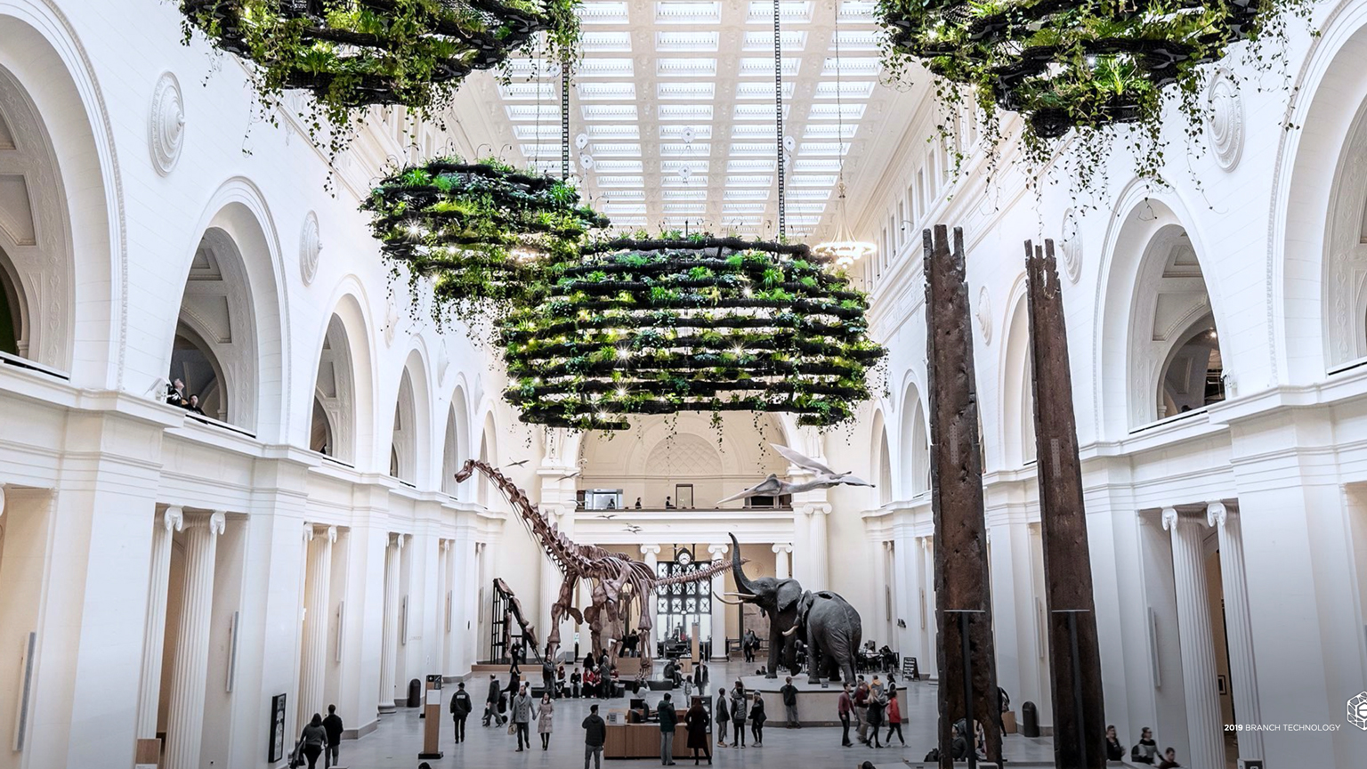

The project centered on the task of showcasing plants from a prehistoric era in a hanging garden called Nature Clouds. The four clouds are part of the Griffin Dinosaur display, which stretches across 21,000 sq ft at the museum's Stanley Hall. It includes the world’s largest dinosaur, a 122-ft-long cast from the fossil bones of a prehistoric beast from Argentina.
The clouds, created by Branch Technology, make up the world’s first freeform 3D-printed garden. The clouds are assembled from 279 parts that weigh 4,000 lb. The clouds contain 12,000 lb of vegetation and support 9,600 lb of steel. The largest cloud system of the installation weighs around 17,500 lb.
