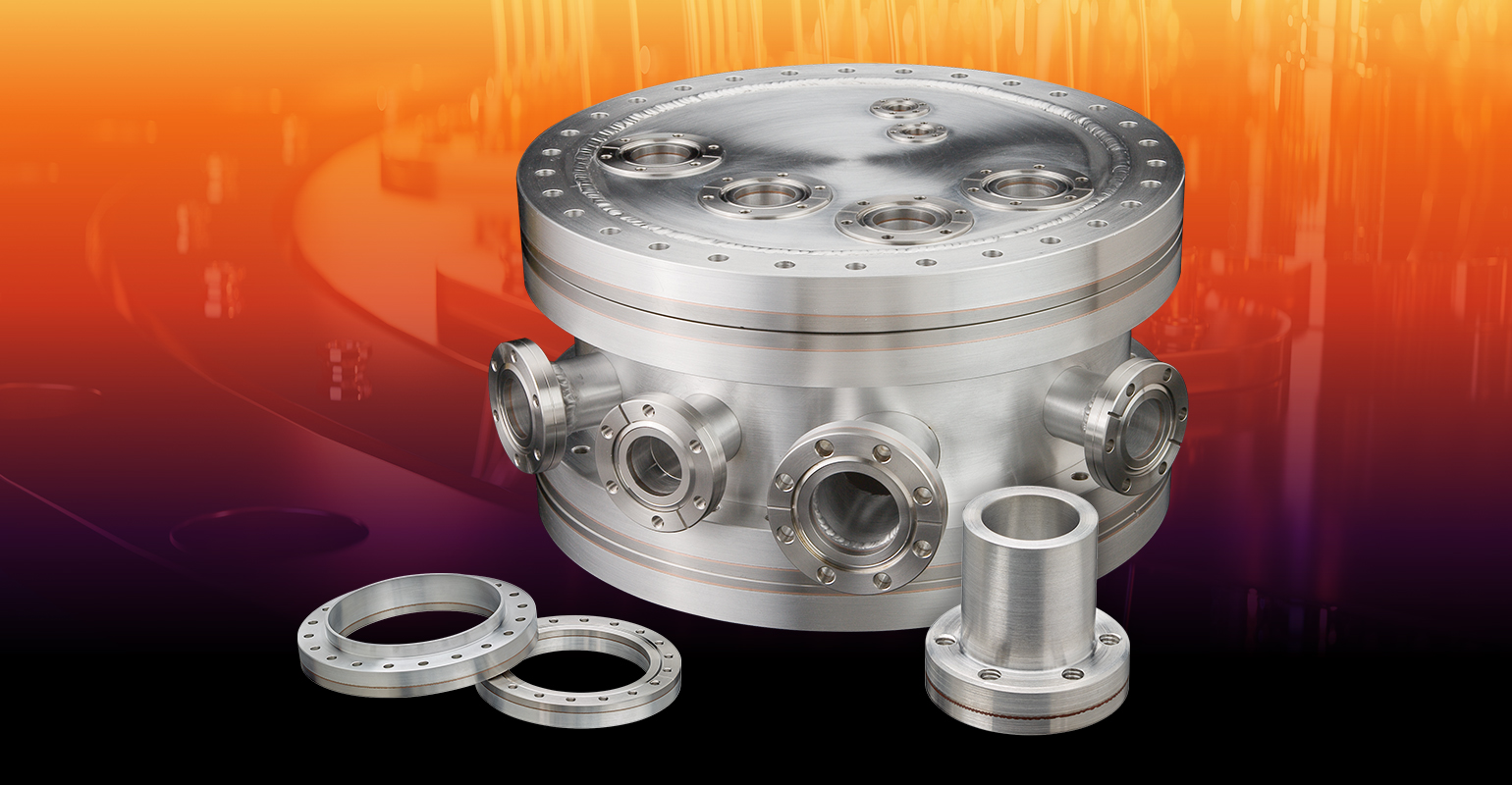

Aluminum Vacuum Chambers used in Lightweight, Non-magnetic UHV Suitcases
Volkvac Instruments needed a UHV chamber light enough to easily carry by hand and that could connect to another UHV chamber to allow transfer of samples under vacuum to a chamber in a new location. The sample handoff had to occur without opening the chambers or requiring bake-out. And the chamber had to be completely non-magnetic to allow transport of samples with delicate magnetic properties.
Atlas Technologies machined a vacuum chamber out of single, solid block of aluminum for enhanced vacuum integrity. Then Atlas bimetal aluminum-titanium flanges were welded to multiple ports of the chamber to allow connection to different vacuum systems. Volkvac fitted the chamber with passive and battery-powered vacuum pumps to maintain UHV pressure.
The result? A portable UHV vacuum system that’s ultralight and nonmagnetic too.
