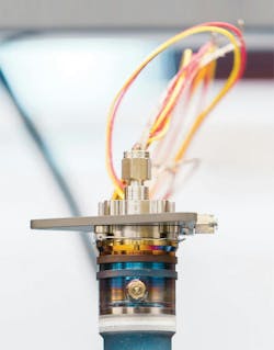

Atlas Technologies bimetal transition in Benchmark Space Systems rocket thruster component
