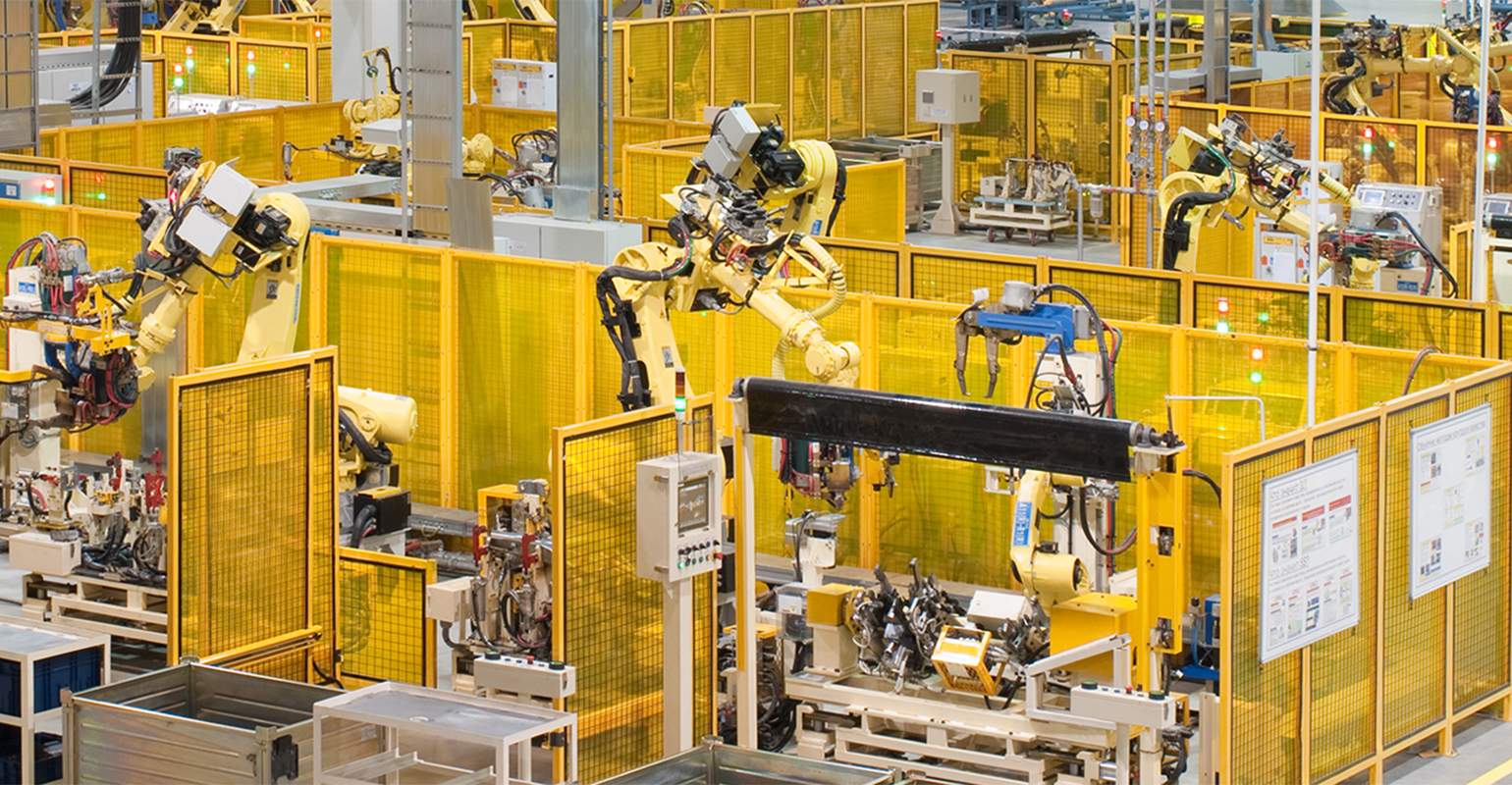

Switches and sensors available with this include noncontact RFID safety switches, self-contained emergency stop buttons, and a transition box that allows dry contact devices to be integrated into the OSSD system (See Figure 1).

These are typically used to replace keyed switches which require precise alignment to operate properly. Misalignment by only a few millimeters can happen when a door sags or a panel shifts on its hinges. Plus, small shifts such as these can cause damage to the switch or the key. As mentioned above, as long as the RFID elements are within 13mm, the device operates effectively. The SRF sensors also provide a warning whenever the actuator is beginning to travel out of range. Precision adjustment is not an issue (10mm assured sensing ON; 25mm OFF), which is ideal for robots, packaging equipment, and pick-and-place machines that are subject to excessive vibration—a major problem for keyed or reed switches. In fact, since RFID sensors are solid-state components, they can be used in a wide variety of harsh environments where shock and vibration are a common factor that would damage other mechanical switches (see Figure 2). Another benefit of the non-contact nature of this technology is that with its mechanical-free operation, there is no wear and tear on the components. Non-contact RFID sensors can provide service life up to 20 years.
