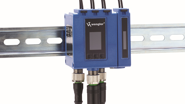

Another option is to use a fiber-optic manifold, which groups multiple fiber channels to one central control and electrical point (Fig. 3). These fiber-optic manifolds typically utilize an OLED display with menus to allow for programming of each fiber channel. Each fiber channel can be configured separately, such as setting light-on or dark-on, and switching hysteresis. This central control also enables grouping of outputs via basic AND/OR logic, which can reduce and simplify the output signal to the PLC.
3. Fiber-optic manifolds with expansion electronics simplify and reduce the number of wires to the machine controller by converting sensor signals to digital data, and combining signals logically if desired. Pictured is AutomationDirect’s new three-channel OPT2042 fiber manifold, which is expandable to 15 channels. It accepts various plastic and glass fiber optics, and transmits and receives data via IO-Link to allow full 15-channel diagnostics on a single 4-pin connector. It can also be wired with two 8-pin M12 connectors to hardwire each channel if needed—for example, in applications where the controller doesn’t support IO-Link.
