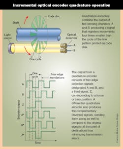

Rotary optical encoders, the most widespread encoder design, consist of an LED light source, light detector, code disc, and signal processor.
Measurement precision reflects the mechanical precision of the pattern on the code disk, but is not limited to it. The reason is that, in a quadrature encoder, each opaque region or “line” produces not one, but four distinct reference points. Two points correspond to the leading and trailing edges of the line itself; two additional points correspond to the leading and training edges from the perspective of a second detector. This not only provides higher resolution, four times that of the code disc, but also indicates direction based on which detector responds first.
The disc has opaque and transparent segments and passes between the LED and detector to intermittently interrupt a light beam. The detector tracks the series of light exposures it receives and sends that information to the processor that extracts motion information.
Two rotary optical encoder subtypes exist: Incremental and absolute.
Incremental encoders are named for their output, consisting of the two square waves, each corresponding to an increment of rotation. Typically, the LED directs rays through a convex lens that focuses the light into a parallel beam; the beam passes through a grid diaphragm, which splits it to produce a second beam of light 90° out of phase. Light passes from A and B channels through a disc onto the photovoltaic or photodiode array. The disc rotation creates a light-dark pattern through the clear and opaque disc segments.
This pattern is read and processed by a photodiode array and decoding circuitry; beams A and B are each received by a separate diode and converted into two square-wave signals ... 90° out of phase, commonly known as quadrature output. It’s then fed into a processor that can process the signal to determine the number of pulses, direction, speed, and other information. Incremental encoders can also have a third channel with a single segment slot or reference that is used to zero or home the device. Alternatively, an incremental sine-wave encoder produces quadrature sine waves (sine and cosine) instead of square quadrature. Arctangent functioning yields arbitrary levels of resolution.

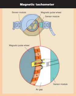

Shown here is a bearingless, magnetoresistive-based tachometer with a magnetic pulse wheel that shares many characteristics with the encoders based on this technology as well. The main difference: Unlike encoders, which track position, tachometers only measure speed.
