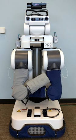

The researchers used a PR2 mobile manipulator made by Willow Garage, a robot manufacturer for the studies. The wheeled robot has 20° of freedom, with two arms and a “head,” and can manipulate objects such as water bottles, washcloths, hairbrushes, and even an electric shaver.

The PR2 is a research and development robot that has two arms and a head on a wheeled base that allows it to move around the environment. (Courtesy: Phillip Grice, Georgia Tech)
