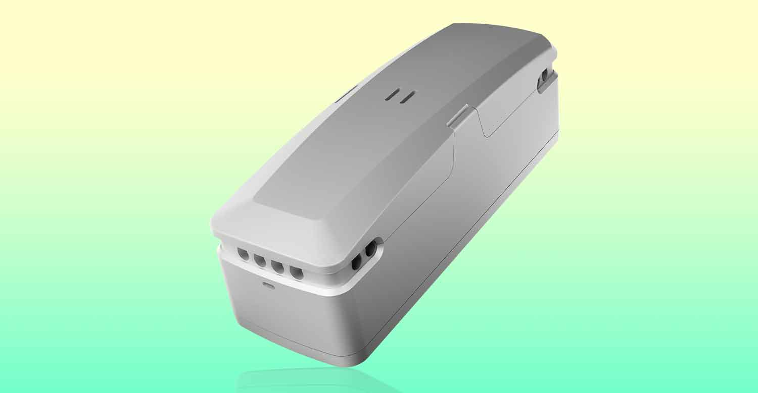

The PJ2 Port Junction Box from LINAK gives users more control for medical applications
The PJ2 Port Junction Box from LINAK gives users more control for medical applications that require advanced sequences by adding two extra output channels without adding a second control box. The PJ2 features standardized technology including a full-bridge power supply circuit., interfaces, and compatibility, letting users to add it to LINAK OpenBus systems. The 0.7-lb box uses LINbus and controls 17 to 50 Vdc. It has a two-channel, 6-pin actuator interface. The output has short-circuit protection and a 10% duty cycle of two minutes on/18 minutes off for continuous use. It carries a flammability rating of V-0, PP, and an IPX6 rating for protection against water and particulates.
