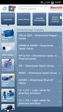

The GoTo Products app from Bosch Rexroth allows you to explore its extensive catalog, including product specs and videos.

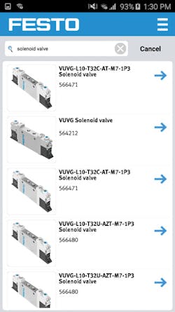

The Festo FAST App places the Festo catalog in users’ hands, helping them buy and ship parts within a matter of days, and even including same-day delivery.
GoTo Products – Bosch Rexroth​
Bosch Rexroth’s GoTo Products app takes advantage of its GoTo Focused Delivery Program. Users can browse popular collections of products for manufacturing automation and machinery engineering. The app provides technical details on each product, allowing users to build a product list, and provides a list of local distributors to purchase the products in the user’s cart. U.S. users can even exploit the built-in eShop checkout process to order all of their parts at once.
FAST App – Festo
The Festo FAST App provides quick and easy access to the company’s FAST catalog. The app is centered around a complete line of industrial automation components that can be delivered in a same-day, three-day, or five-day timeframe. With access to more than 1,000 Festo automation components, the program enables engineers to gain access to wide of selection of inch and metric components, lower inventory costs through “Just in Time” delivery, reduce time to market for prototype and production projects, and create savings by easing up inventory demands and time to build. The parts available to users include pneumatic cylinders, pneumatic actuators, valves, valve terminals, sensors, actuators feedback, servo drives, electromechanical

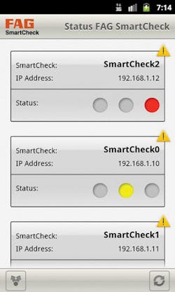

The FAG SmartCheck app from Schaeffler connects the phone to the FAG SmartCheck sensors placed on devices around the plant floor to monitor active vibration.
Mobile Tools and Diagnostics
Companies have created mobile apps that turn a device into another piece of equipment on the plant floor. These apps offer users a way of measuring vibrations and sensor readouts by capitalizing on the built-in antennas and sensing equipment in smartphones.
FAG Smartcheck – Schaeffler
The Smartcheck from Schaeffler is a vibration sensor that can be easily mounted onto a device. The sensor uses crystal-based accelerometer structures to send out voltage signals that are interpreted to detect velocity and orientation. The sensors themselves connect to a local network via an Ethernet connection. Once on the network, you can go mobile by accessing the Smartcheck app. The app allows you to connect with any sensor on the network to see its unique IP address and the status of each machine.

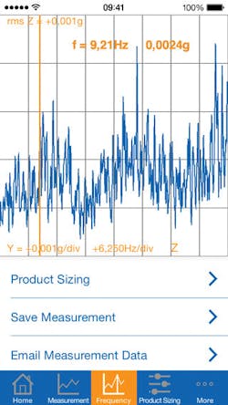

VibroChecker – ACE
Smartphones typically have built-in accelerometers, which are typically used to detect when a person gets up or moves around, or when the phone is picked up for use. However, ACE’s engineers turned those accelerometers into vibration sensors. An engineer can quickly measure simple vibrations on machines and components with a frequency range of up to 50 Hz. Depending on the readout, the app can also suggest corrective courses of action by recommending dampening products designed by ACE.
By turning the accelerometers in your smartphone into a measuring device, the ACE Vibrochecker turns your phone into a measuring device of vibration detection.

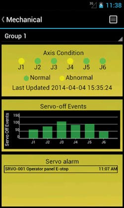

iRConnect – FANUC
The apps designed by ACE and Schaeffler demonstrate how phones can be more useful for monitoring conditions. FANUC designed a similar app to communicate with its robotic controllers. The iRConnect app communicates to the FANUC robotic arms and can provide information on the number of robots in a zone, the health of the robot, cycle time, maintenance events, and axis conditions of the arm per joint.

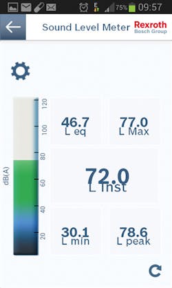

Fit4SILENCE – Bosch Rexroth
​Bosch Rexroth’s Fit4SILENCE app uses another phone function to create a handy diagnostics tool. By turning the phone’s microphone into a listening device, the app can measure noise levels at accuracy levels comparable to most professional sound-level meters. The app records a profile of the sound level in decibels over an allotted time. The app also records the sound level in a raw data format, which can be saved for further analysis. Furthermore, it suggests Bosch Rexroth products that would help reduce noise.
The FANUC app iRConnect helps users monitor their robot controllers, providing maintenance status, the number of robots on site, and the current status of each joint on a robot arm.

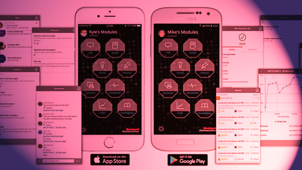

Up to this point, all of the apps we have discussed serve a single function—whether that involves being a catalog for part ordering or a diagnostic tool. However, these apps have yet to exploit the potential of interconnected smart devices when introduced on the plant floor. Representing the future of apps, the FactoryTalk TeamONE from Rockwell Automation utilizes the strong connectivity features of smartphones.
FactoryTalk TeamONE – Rockwell Automation
The FactoryTalk TeamONE app is more than another diagnostic tool. The app is a smart node on the network rather than a client that connects to the server. As a result, the device module communicates directly to the devices on the network, and can directly view live data. The app offers diagnostic messages that allow users to interact with machine alarms and troubleshoot devices. It also helps team members to collaborate by connecting the primary user to other users on the same network, thus increasing team productivity and reducing mean time to repair.
Using a smartphone’s built-in microphones, the Fit4Silence app developed by Bosch Rexroth turns the device into a noise-detection tool.
Employees can choose from a variety of modules to directly view information from devices such as Allen-Bradley PowerFlex drives, or else observe the high-level health status of any EtherNET/IP device. After solving a particular problem, the lessons learned from the incident can be flagged. Then, the next time a similar problem arises, the team will be able to call up those lessons. The initial release of FactoryTalk TeamONE is available now and includes eight modules: Incident, Device Health, Teamboard, Knowledgebase, Connect, Pinboard and Chat, Connect, and Trend.
When speaking with Kyle Reissner, the mobility platform leader of Integrated Architecture at Rockwell Automation, we addressed the importance of having an app that opens up the possibilities of smart devices.
“The app can be used by anyone at any level to combine experience-based knowledge with contextual automation device data and solve problems quicker as a team, or even as an individual,” said Reissner. “We’ve heard from many of the TeamONE early adopters that engineers and maintenance team members use it to investigate issues. They also use the app to assist with new machine installation or commissioning and collaborate with colleagues without needing to connect to devices through plant-floor networks.”
The FactoryTalk TeamONE app from Rockwell Automation offers a glimpse into the future of company apps—it provides network notifications, team collaboration, and instant connectivity to connected devices.
When asked about whether or not investing in apps is beneficial, Reissner replied that “We believe apps can reduce the friction for all industrial workers to realize value and thus be more productive. Using an app with new innovations and approaches like FactoryTalk TeamONE can drive what we call ‘frictionless productivity gains’
“Apps can also provide new functions by tapping into the local power of the device,” he concluded. “The smartphone is really a supercomputer packed with a ton of sensors, and we’re just starting to explore those capabilities.”
