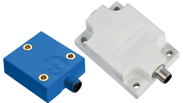

BEI Sensors has introduced the T-Series industrial inclinometer which is a compact sensor for measurement of slope or tilt angles of an object with respect to gravity. It uses MEMS technology and
BEI Sensors has introduced the T-Series industrial inclinometer which is a compact sensor for measurement of slope or tilt angles of an object with respect to gravity. It uses MEMS technology and offers a wide range of motion feedback, including dual axis up to ±60° or single axis of 360°. The inclinometer has a resolution of 0.01° and accuracy of 0.1° and incorporates built-in linearity and temperature compensations—both for offset and sensitivity. It features an encapsulated sensor and a glass fiber reinforced plastic or an AW6082-T6 aluminum alloy housing. The plastic is made with automotive grade UV resistant material with UL 95 V-0 classification for safety of flammability. The T-Series industrial inclinometer is meant for tilt measurement applications on industrial equipment like mobile cranes, forklifts, drilling towers, construction, and agricultural machinery.
