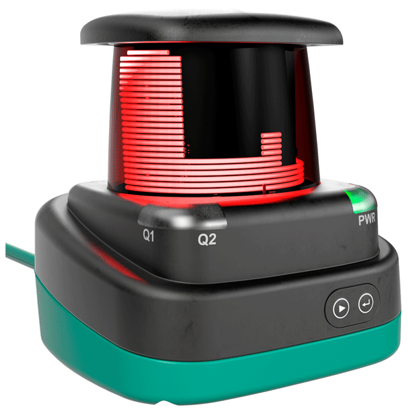

The R2000 UHD laser scanner features pulse-ranging technology (PRT) for 360° distance measurement.
The R2000 UHD laser scanner features pulse-ranging technology (PRT) for 360° distance measurement. The combination of the PRT and a rotating head lets the IP65-rated 2D photoelectric sensor deliver quick, precise, and high-resolution distance measurement. A gapless 360° measuring angle and interactive wrap-around LED display results in highly reliable detection of objects to 10 m (33 ft) and/or reflectors to 60 m (197 ft). The eye-safe, Class 1 red laser allows for quick and easy set-up and alignment. The LED display is capable of both text-based and graphical information, as well as providing an image of the scanned environment.Additional features include a high 50-Hz scan rate (3,000 rpm), that detects protrusions or obstacles over a large area and at high speeds; 360° scanning angle for positioning, area monitoring, or collision-avoid
ance applications; fast Ethernet interface capable of transmitting data at speeds up to 100 Mbit/sec; and rated for use in temperatures from 14 to 122°F.
