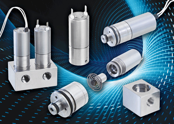

The DV Series bidirectional high-flow electronic valves offer flows to 100 liters/min. The precision-built, two-way valves use a patented valving principle and come in a variety of voltage, connector, and mounting options. Options include: • Medium: Air or compatible gases (40-µm filter) • Airflow: Standard: 100 liters/min @ 100 psig; “-L” option: 100 liters/min @ 50 psig
Options include:
• Power Consumption: 1.9 W
• Operating range: 90 to 150% of rated voltage
• Temperature range: 32 to 180°F (0 to 82°C)
• Mounting: Manifold or cartridge style (inserts into a ¾-in. bore)
• Electrical connection: Spade terminals or wire leads
• Ports: #10-32 or M5 (on manifold-mount valve)
• Orifice: 0.052 or 0.070 in. (-L)
• Response: 10 to 15 msec
• Voltage: 12 or 24 Vdc
• Wetted material: Ultem, PPS, stainless steel
• Seal material: Nitrile standard; silicone, FKM and EPDM optional.
Additional features include leak-free operation, over 1,000,000,000 cycles, accommodates large flows with more stroke, low heat rise/low power, and stainless-steel “Spider” flat spring.
