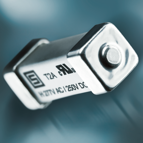

The UMT-H Series of SMD fuses now come in 13 additional rated currents, for a total of 19 ratings from 160 mA to 10 A at voltages to 277 Vac and 250 Vdc. The fuse’s time-lag characteristic provides overcurrent protection while protecting against short circuits up to 1,500 A at rated voltage.
The UMT-H Series of SMD fuses now come in 13 additional rated currents, for a total of 19 ratings from 160 mA to 10 A at voltages to 277 Vac and 250 Vdc. The fuse’s time-lag characteristic provides overcurrent protection while protecting against short circuits up to 1,500 A at rated voltage. The UMT-H’s 277-Vac-rated voltage protects power-supply units, power circuits, sensors, single-phase industrial appliances, and devices required to meet explosion-protection standards.
