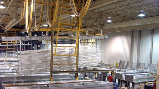

Plants that operate on nearly a 24/7 schedule have no room for unexpected downtime. Such is the case with Linetec Inc., Wausau, Wis., a company that provides architectural metal finishing services including painting, powder coating, and anodizing.
On its finishing lines, the facility employs a computer-controlled hoist system to guide material through its anodize process, eliminating any chance of manual variations in precleaning, etching, anodizing, coloring, or sealing. The system ensures a consistent and durable finish on every load that travels through its lines.
However, any system is only as strong as its weakest link, which in this case was the dry brakes used to stop and position the hoists. The brakes required weekly maintenance in addition to monthly overhauls, yet they still experienced periodic failures that brought the anodize process to a standstill. After exploring several different braking options, Linetec maintenance engineers investigated oil shear brake technology from Force Control Industries, Fairfield, Ohio, and decided to try it in their plant.

To move parts from station to station, Linetec uses eight cranes, each with a 3-hp trolley motor and 15-hp hoist motor. Every motor performs 2,000 moves per shift. Previously, dry Stearns brakes were mounted on each motor to stop and position loads. Because these brakes employ a disc as a sacrificial wear surface, each one had to be checked weekly. In addition, each brake had to be completely rebuilt on a quarterly basis, entailing disassembly, disc and solenoid replacement, checking the gap, and reassembly. This required 7.5 min. for each crane during weekly maintenance, plus 30 min. each per quarter, totaling 124 hours each year on preventive maintenance. In addition to time, the plant was spending another $8,000 per year on maintenance parts, not including unexpected breakdowns.
