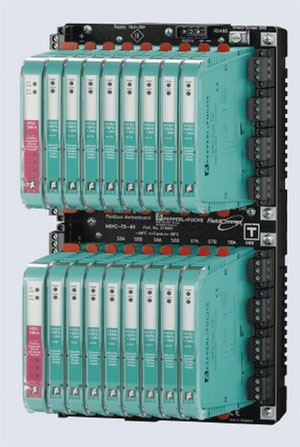

The FieldConnex compact power hub targets larger process automation projects. It delivers eight segments of redundant power in less cabinet space than comparable supplies
The FieldConnex compact power hub targets larger process automation projects. It delivers eight segments of redundant power in less cabinet space than comparable supplies. The hub supports intrinsically safe fieldbus segments according to Entity Ex ic or Ex nL classification and the High-Power Trunk concept. The modules are available for 21...23-V/500-mA or 28...30-V/500-mA operation.
The hub’s design concept is a compact motherboard that provides all necessary wiring connections and interfaces. All connections are plug-in with retaining screws for long-lasting connections, even under continuous vibration. The motherboard can hold up to 16 plug-in power modules to supply redundant power for up to eight Foundation Fieldbus H1 segments.
