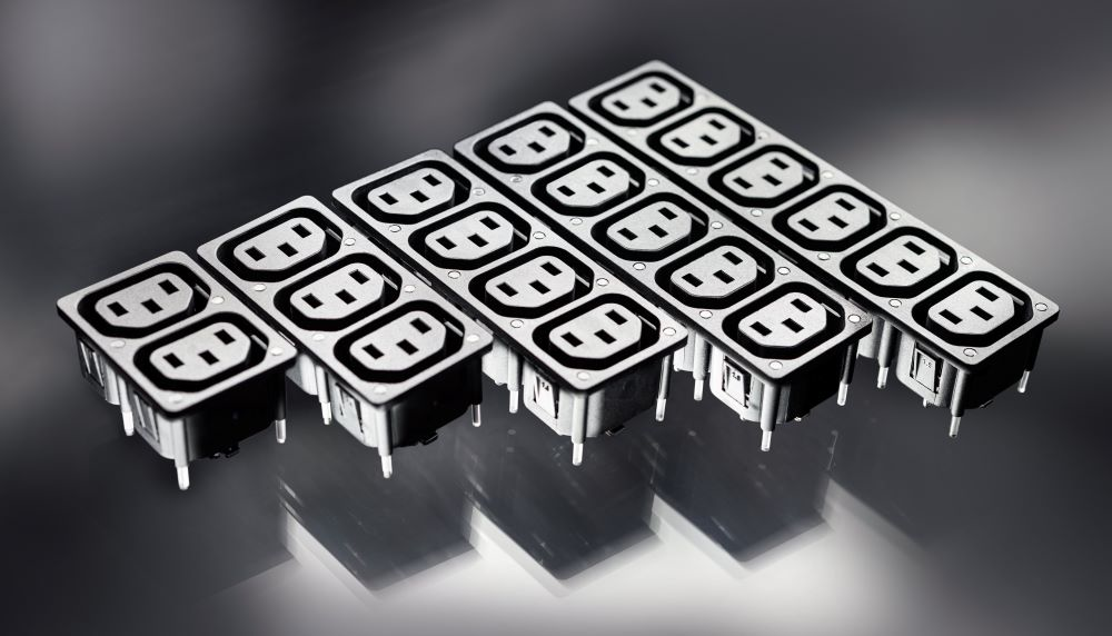

The 4750 series connectors from SCHURTER meet power distribution demands and save space.
The 4750 series IEC strip-block, IEC connectors Type F meet the highly specific demands of power distribution in data centers. The strips provide a host of features including numbers of outlets in a strip, lighting possibilities and terminal configurations for a range of standard options. Users can choose from 2-7 outlets, IDC bussed or conventional terminal connections, status-indicating light pipes and three different colors to meet the universal needs, as well as tailor-fit needs of PDU applications.
The 4750 series power strips neatly and compactly integrate functionality to save space in densely packed PDUs. In complex power distribution systems, especially with extensive power monitoring capabilities, the visualization of status is of great importance. The 4750 provides status indication light-pipes in all positions of the outlet with 1, 2, L and N as standard, in addition to traditional strips with no light-pipes. Illumination options include red, green and white.
