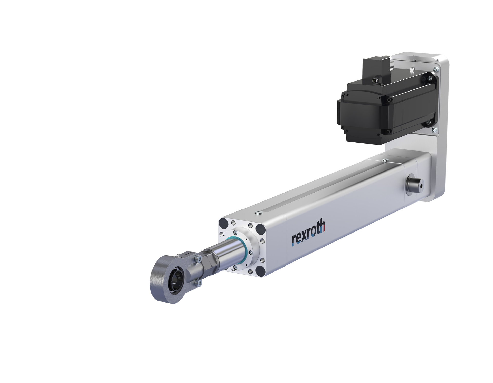

Available in three sizes, Bosch Rexroth's EMC-HPs are well-suited for heavy loads.
The EMC-HP electromechanical cylinders are designed for heavy loads up to 100 kN. The new actuators are robust, compact and low maintenance. The planetary screw drive design providers continuous power even under harsh conditions thanks to both the new oil-bath lubrication and the optional water cooling directly on the screw itself. As with the other members of the EMC family, a fully digital process, from selection through to ordering, shortens the engineering time.
The EMC-HPs are currently being launched on the market in three sizes—115, 130 and 160 (housing diameter)—with protection class IP65. They are suitable for a range of different heavy-duty applications with strokes of up to 1,500 mm, from pressing, forming and riveting to tensioning, positioning and testing. The design also increases lubrication intervals and the seals can be replaced in just a few steps if required.
