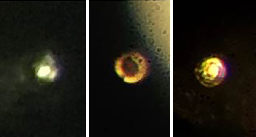

The image below shows the hydrogen's phase transitions at different pressures.
Three phases of hydrogen are shown during compression. The pressure breaks the bonds between diatomic hydrogen and then further compresses the atoms so that electrons can flow freely between nuclei. Starting as a transparent gas, the sample begins to darken at 2 gigapascals as it transitions into a semiconductor. At 495 gigapascals, it appears to become a light-reflective metal. (Courtesy of Physics.org)
