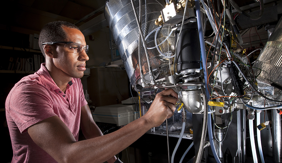

Sandia researchers Isaac Ekoto pictured and Benjamin Wold are part of a team researching automotive engines that replace sparkplugs with autoignition devices The research could help meet automotive engine goals for cleaner emissions and a 545 miles per gallon fuel economy by 2025
