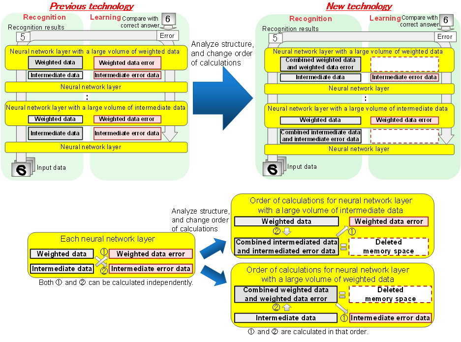

With the introduction of a new memory system, Fujitsu announces development of a GPU that enables more layers in a DNL network without compromising its speed. Adding more layers will improve the overall accuracy and learning capacity of the GPU. At each layer, the GPU will compare the weights of nodal connections to a “weight error” calculated at the end of each iteration and will simultaneously compare the data stored at each layer to the “data error” calculated by the GPU. By subtracting the errors from the existing weights and data, the GPU can actually delete excess data and weights stored at each layer. This frees up more memory space so that they GPU can operate faster, storing only data that is necessary.
Courtesy of Fujitsu. Click to enlarge.
The new memory system is tested in the Caffe open source deep learning framework software. Evaluations used AlexNet and VGGNet, which is common in DNL research initiatives. Fujitsu reports that it reduced memory usage by 40% with the new system, nearly doubling the learning capacity and speed of the DNL network. The company plans to release the technology in March 2017 for use in its Human Centric AI Zinrai
