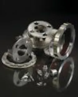

The Metal Powder Industries Federation handed out its Powder Metallurgy Design Excellence awards in automotive, aerospace, industrial, and other categories.
Powder metallurgy (PM) continues to make inroads into the automotive, aerospace, industrial, and consumer markets as evidenced by the winners of the 2010 Powder Metallurgy Design Excellence Awards Competition. The awards, sponsored by the Metal Powder Industries Federation (MPIF), were announced at PowderMet2010, the 2010 International Conference on Powder Metallurgy & Particulate Materials, in June.
MPIF officials noted that many of the winners stretched the limits of powder metallurgy techniques. Winning parts also received kudos for cutting costs, eliminating secondary operations, and greening production processes.
