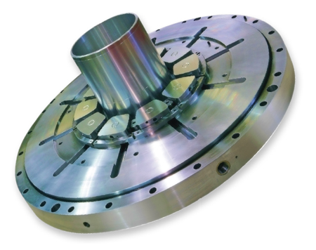

Thrust bearings typically have flat bearing surfaces whether they are designed with pivoted or spring-supported pads. In these bearings, central lift pockets can provide hydraulic lift. Lifting oil spreads out from such a pocket when oil-feed pressure is about 500 psi higher than the contact pressure around the pocket.
To determine the equilibrium hydraulic supply pressure, Ps, in the pocket needed to balance the load in a thrust pad, use the following expression from Khonsari and Booser (see Resources). It is derived from the concept of an equivalent circular pressure field.
where W = load, lbf, on a single bearing segment; R1 = outside radius, in.; and R2 = the pocket radius, in.
The area, A, of a conventional wedge shape can be approximated by the product of the segment radial length, B, and the length of the outer arc, L, both in in. This can be converted to a circular area with outside radius, R1:

Tailoring the lift pocket shape and size to an application can improve lift performance. Choose an elliptical shape with the long axis in the direction of rotation. The shape should straddle the bottom centerline in journal bearings so it doesn’t induce shaft rotation. Larger pockets and flared edges increase lift area and cut the oil pressure needed to generate lift.
The location and number of pockets is also important. Limit the axial spacing between lift pockets along the bottom of a sleeve bearing to about one-fourth of the journal diameter. For flat, pivoted thrust bearings, stick with a single central pocket in each segment.
